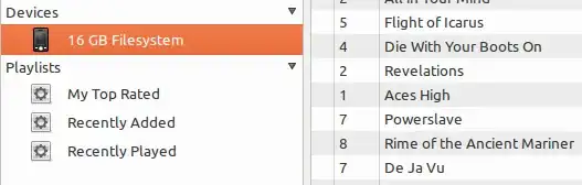

As others have mentioned, Android-based phones work out of the box. My Nexus One shows up as mass storage, which lets me manage it via my music player, photo editor, etc. You can drag and drop things to it like any device:
alt text
The one problem with the default music application (Rhythmbox) is that the playlists currently do not sync. This problem will be addressed in a future version. However the Banshee media player currently manages this quite well, which is what I use to manage the music on my Nexus.
The other downside for you might be that you have to use Google services to get the over-the-air syncing goodness. So if you have your contacts/calendar/email locally in your applications then you have to find a syncing solution vs. if you use gmail everything just works transparently. Some people might not like this but I find it to be a very handy feature. Having owned both a blackberry and an iPhone 3G (which I needed to plug in and sync) there's much less hassle to have everything syncing over-the-air.
Also, depending on whether your carrier has Android 2.2 and doesn't disable tethering it just works when you plug it in.
