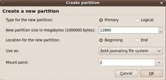

As I know most of the Ubuntu applications are installed in /usr . so while you creates the HDD 1 partition , set its mount point to /usr , so that all your applications will installed into HDD1 as you want.
I mean in this step( A sample image) , set mount point as /usr for HDD1
hope that helps.
