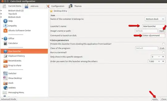

To add a program, just right click on the dock, and click on Cairo-Dock --> Add --> Custom launcher. Once the new window opens, just fill in the needed info, and click apply. See images below.
See the new program added to the Dock
