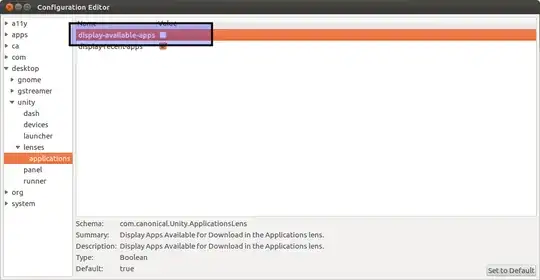

This is possible in Unity version 5.0, which will be part of Ubuntu 12.04.
To get rid of the "Apps Available for Download" section:
  1. launch dconf-editor (which is part of the dconf-tools Install dconf-tools package)
  2. navigate to /desktop/unity/lenses/applications
  3. uncheck the display-available-apps box
(There's also a display-recent-apps option available to disable the corresponding section.)

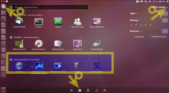

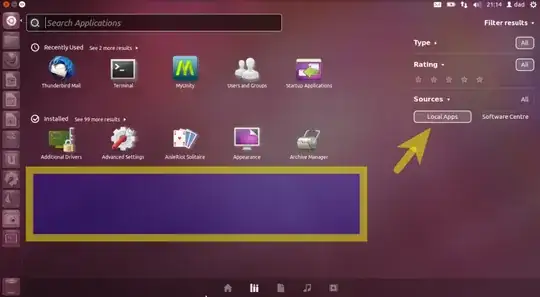

Configuration of Display Available Apps to download is directly configurable from the Dash
  1. Open the Dash
  2. Click the lens as Application Lens
  3. Click the down arrow to reveal the Filter Results options
  • To switch off the display of applications to download click the Local Apps source
  • To turn on the display of applications to download click the Software Centre or All

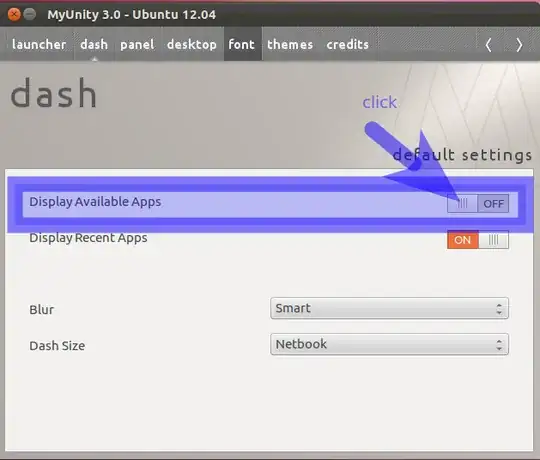

Configuration of Display Available Apps and its counterpart Display Recent Apps is now available directly via the GUI configuration application MyUnity
The image shows the option turned off - you can click as shown to switch-on the Dash display of available applications.
