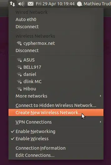

You can very easily create an ad-hoc WiFi network using NetworkManager, so if the other system you want to connect to it supports that, it's most likely the easiest solution:
Click the NetworkManager icon in the menu, and look for the equivalent of Create New Wireless Network...;
menu item

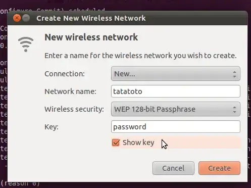

Choose New... from the drop-down list (if there is one) and enter the information: the name you want for the Ad-Hoc network, its security, and password if you choose a security type. Note that WPA/WPA2 seems to not work so well, I've had much better luck with WEP or no security.
new adhoc network settings
