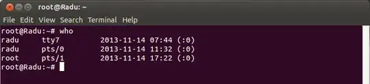

In Ubuntu it seems that there is an alternative to get root logged without to enable his account. The following command will do this:
pkexec env DISPLAY=$DISPLAY XAUTHORITY=$XAUTHORITY gnome-terminal
This will open a root terminal:
root terminal
