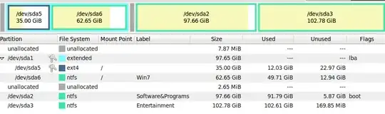

Here is my Partition table configuration(from gpartd):

Another problem that I am at loss of 3GB of space on sda5 (ubuntu) partition. gparted is showing its a 35 GB partition but Disk utility shows its a 38 GB partition as shown bellow: enter image description here Why is it so.How do I recover it.

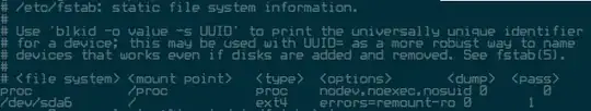

Contents of /etc/fstab: enter image description here
gkt
  • 255
I think you can fix it with Mount-Manager.
But first backup your fstab (sudo cp /etc/fstab /etc/fstab.bak).
You have not lost 3GB, this is how each software interpret the space of the disk. Look at your others partitions, all are "smaller" at GParted.
