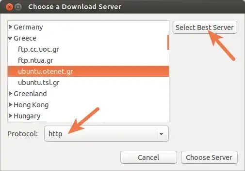

Also, I will add that I personally always use the best server found by Ubuntu (in System Settings...Software & UpdatesUbuntu Software tab, and choose Othher...):
choose server
