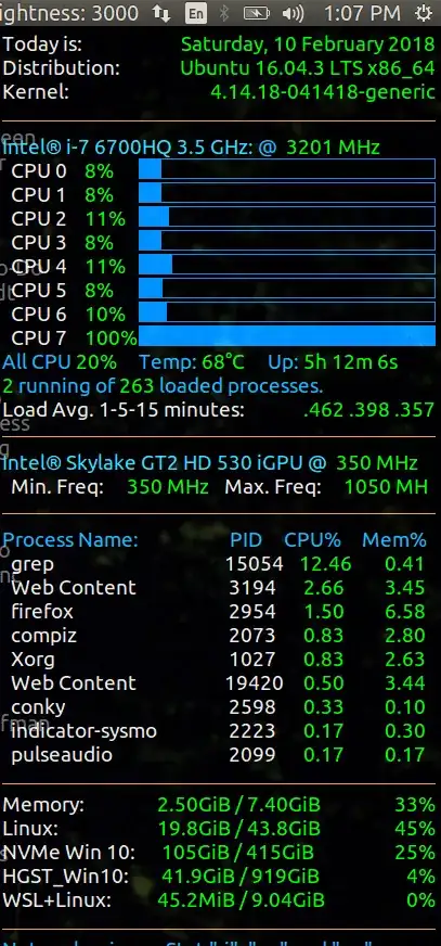

Alternate GUI method using Conky
Other answers mention alternate methods to the basic CLI (Command Line Interface). I like to use Conky to do this. In the example below the Skylake CPU has a regular frequency from 800 MHz to 2600 Mhz. With turbo boost enabled the frequency can jump to 3500 MHz under heavy load.
The .gif sample below starts out by showing frequency fluctuating around 3100 MHz under heavy load when grep is running on the whole file system. Then the command is issued:
$ echo "1" | sudo tee /sys/devices/system/cpu/intel_pstate/no_turbo
...to shut off turbo boost. Speed drops to fixed speed of 2600 MHz which is the regular maximum speed without turbo.
Then the turbo command is reversed:
$ echo "0" | sudo tee /sys/devices/system/cpu/intel_pstate/no_turbo
...to turn turbo back on and speed jumps above 2600 MHz and fluctuates around 3100 to 3200 MHz again.
Toggle turbo boost
Notice how quickly temperature jumps 10 degrees when Turbo is turned on

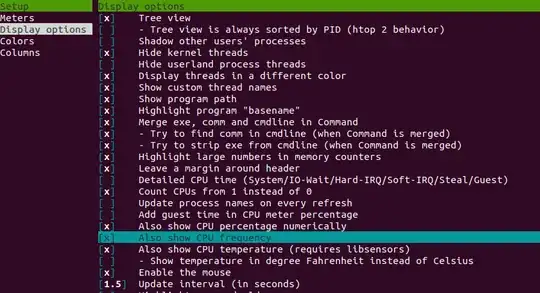

You can see the working of turbo boost in ubuntu in real-time using htop.
  1. Install htop:
    sudo apt install htop
  2. Open it by running htop in the terminal. You will see a graphical window in the terminal.
  3. Click Setup with the mouse or press F2.
  4. Click on the Display options and enable Also show CPU frequency:
    htop display options
  5. Click Done or press F10 to save the settings.
Now you can see the turbo boost is working by looking at the real-time CPU frequency. In the following screenshot, for example, the base speed of my i5 processor is 2.5GHz, but you can see the turbo boost is kicking in and giving more than 3GHz.
example screenshot showing turbo boost
In addition, htop can display how much percentage of the core is used along with the temperature as well and htop displays the statistics more graphically in the terminal window itself. The advantage of using htop over other tools mentioned in this question, we can see which process is taking more resources in terms of CPU used and memory used. Users can kill the process if they want to.
