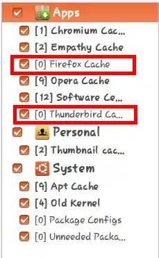

I usually use Ubuntu tweak to do cleanup jobs on my PC. This includes apt and program cached data and old kernels. This goes alright for most programs except Mozilla based application - Firefox and Thunderbird.
Ubuntu tweak doesn't seem to know where their cache folders are and always returns 'zero packages can be cleaned' even when the cache folder is full. Check screenshot below:
Screenshot showing empty firefox and thunderbird cache folders
I am looking for a way to clean up ALL my cache data and unneeded packages at one point.
If someone knows how to change the ubuntu tweak cache folders for Firefox and Thunderbird, that would be perfect.

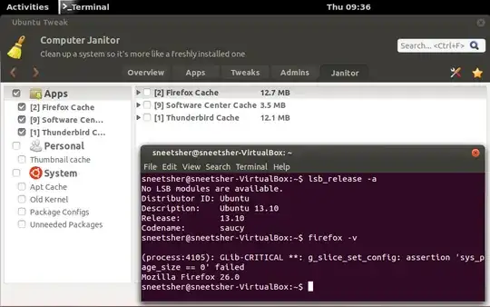

As I tested Ubuntu Tweak 0.8.6 in Ubuntu 13.10. It seems that for both, late releases of Mozilla Firefox and Thunderbird moved their cache folders to ~/.cache. Profiles configuration kept in same place ~/.mozilla/firefox/profiles.ini and ~/.thunderbird/profiles.ini.
  • Firefox: ~/.mozilla/firefox/~/.cache/mozilla/firefox/
  • Thunderbird: ~/.thunderbird/~/.cache/thunderbird/
Quick patch:
sudo nano /usr/share/pyshared/ubuntutweak/janitor/mozilla_plugin.py
Add/Change all lines I include cache_path in them (3 new lines, 2 modified app_pathcache_path, keep app_path of the profiles.ini):

I filled an upstream bug report for this, See Cache path of Mozilla Firefox and Thunderbird changed to ~/.cache #24

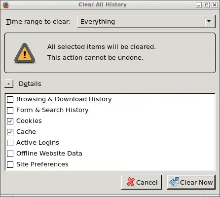

For firefox you could install firebug. Once firebug is installed into firefox you can do a:
ctrl shift del
This will bring up the clear history dialog which includes clearing cache. Giving you nice control over what you clear and what you don't. Here is a screenshot of the feature:
