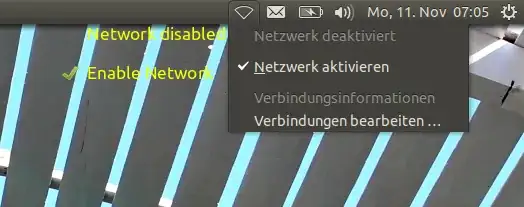

since I use Ubuntu 13.10, I'm experiencing a bug:
  1. I activate standby
  2. I press any key to continue working on my laptop
  3. The computer is on again, but the wlan doesn't work.
After Standby… Hitting "Enable network"
→ The wlan network then is disabled by default, but I can't enable it, it doesn't shows any network available.
