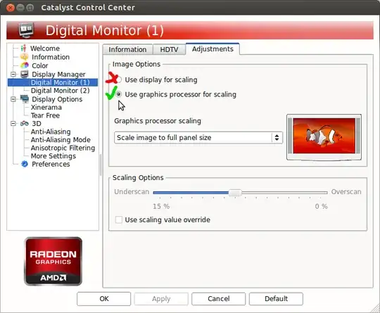

I also had a flickering with my second monitor. Interestingly only when I used DisplyPort. I had no problem with DVI. I could solve the problem within the AMD Catalyst Control Center by setting the Image Options from "Use display for scaling" to "Use graphics processor for scaling" on both monitors. Now I have no problem with flickering anymore.
See image:
Card: AMD Radeon HD 9600
Driver: 13.35
Catalyst: 2.20
RandR: 1.3
Ubuntu: 12.04
