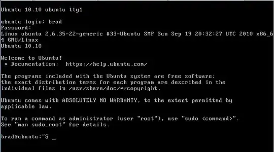

By default the Server version of Ubuntu has an interface similar to this one:
server interface of Ubuntu
So, only the command-line is available.
Source: Ubuntu Server “desktop” versus Ubuntu Desktop Version.
