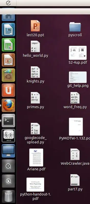

UPDATE
Screenshot after running
xrandr --addmode VGA1 1360x768
As you can see, side bar is not completely visible and Ubuntu logo at the task bar is missing. Also when you open an application, the Task bar of the application (where it should go to the top panel) is missing as well..
