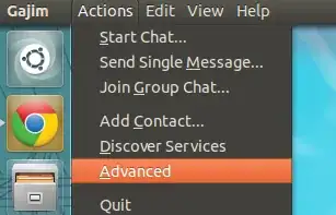

I just installed Gajim 0.15.4 from Ubuntu repository on Ubuntu 13.10.
Advanced, as far as I know, is supposed to be a sub-menu. Clicking on it does nothing.
What can I try to fix this problem?

the only workaround i've found is to disable the global menu for gajim as described for eclipse here :
https://askubuntu.com/a/371447
https://stackoverflow.com/a/19526584
So just replace Exec= line content by this :
Exec=env UBUNTU_MENUPROXY= gajim
Gajim will stop to use globalmenu and you will get your submenus back ;)
