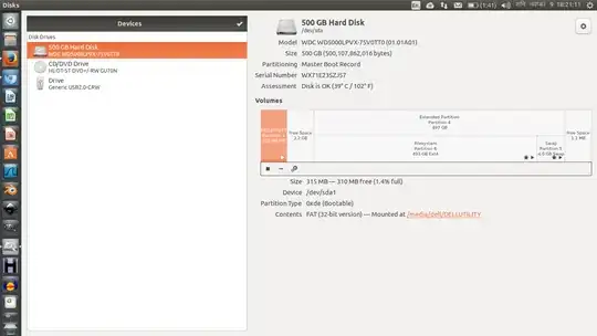

snapshot of my disk
That's the layout of my disk. I want to merge free space to the primary partition without data loss.

Yes, you can merge the 3.2gb free space to your Ubuntu partition.
  • For this you need a gparted-live-disk.Because you cannot resize a mounted partition when the filesystem is mounted.
  • Boot into gparted live disk
  • Right Click on the Extended partition and select Move/Resize option, then add the unallocated 3.2 gb space to it.
  • Now the unallocated 3.2gb space comes under the extended partition.
  • Then rightclick on your Ubuntu ext4 partition and select Move/Resize option,now 3.2gb free space will be shown and you can add that.

I guess in your case it is not possible to merge 3.2GB free space with your extended partition because it is in the beginning of your partition.
