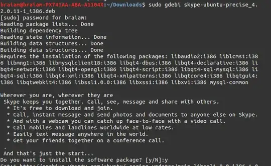

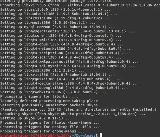

To install Skype, the only version is Precise 12.04 (multiarch). I wouldn't recommend --force-depends as Radu's answer but the use of Gdebi:
wget http://download.skype.com/linux/skype-ubuntu-precise_4.2.0.11-1_i386.deb
sudo apt-get install gdebi
sudo gdebi skype-ubuntu-precise_4.2.0.11-1_i386.deb
It will install the dependencies automatically and you will be assured that everything will be fine.
