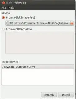

you can use WinUSB application. To install open your terminal and paste these lines
sudo add-apt-repository ppa:colingille/freshlight
sudo apt-get update
sudo apt-get install winusb
Credit Goes Here

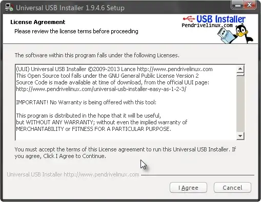

Click the I agree button:

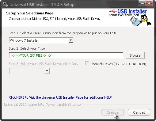

Select your version of Windows: (for example Windows 7 installer)
Now click the browse button, and locate your .iso file
The last thing is to select the drive you want it to install to, please be careful here, if you select the wrong device, i do NOT know what may happen
at last, click the create button:
installer
(On my screen it's greyed out, because i didn't select an actual ISO file)
