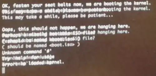

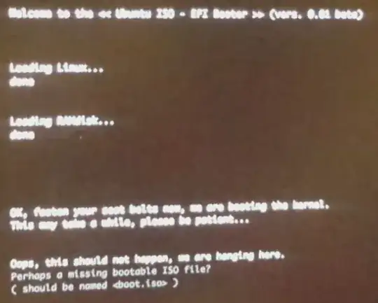

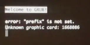

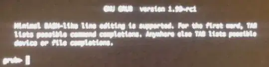

While attempting to boot, I end up in the grub shell. I video recorded my screen and have some screen shots here.
enter image description here enter image description here enter image description here enter image description here
How do I proceed booting? I care more to install linux on my mac mini (late 2012) than to fix this issue. I will be happy to boor boot manually and start the installer. I am installing ubuntu-13.10-server-amd64+mac.iso

The following worked for me.
grub> kernel (hd1,gpt2)\vmlinuz-3.11.0-13-generic root=/dev/sdb3
grub> initd (hd1,gpt2)\initrd-3.11.0-13-generic
grub> boot
