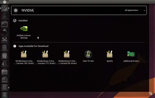

  1. Go to SystemAdministrationNVIDIA X Server Settings or click on the Applications lens in the Launcher and search for NVIDIA.
    applications-lens-search

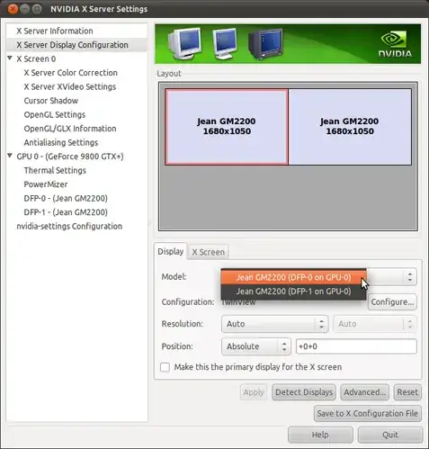

  3. From the Model drop down list select the display you want to activate.
    nvidia-x-display-settings-model
  4. Click on Configure and select the option you need.
    nvidia-x-display-settings-model-configuration
