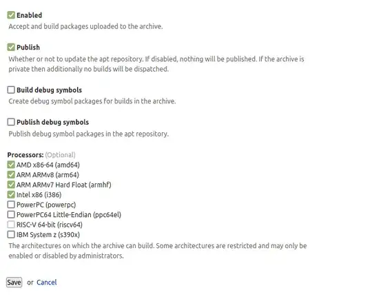

As of 8 November 2016, enabling ARM builds is self-service: you can change an option in the PPA settings to get it to build for any of the following architectures automatically (documentation link):
  • AMD x86-64 (amd64)
  • ARM ARMv8 (arm64)
  • ARM ARMv7 Soft Float (armel)
  • ARM ARMv7 Hard Float (armhf)
  • Intel x86 (i386)
  • PowerPC64 Little-Endian (ppc64el)
  • PowerPC
  • IBM System z
Launchpad PPA settings

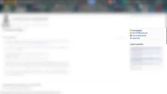

Log in and select "Change details" in the upper right corner of your PPA page. At the bottom of the page that follows, you'll see the above options that can be enabled.
Change details settings
