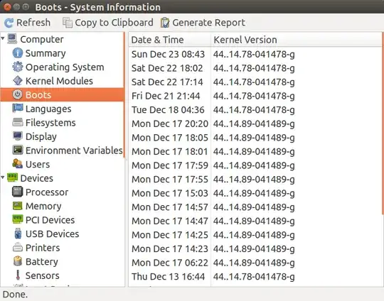

For a GUI method you can use hardinfo as described here: Does Ubuntu have a "device manager" equivalent? And what is an easy way to access USB drives?.
Under the section Boots you will see this:
Installation is straight forward using:
sudo apt install hardinfo
