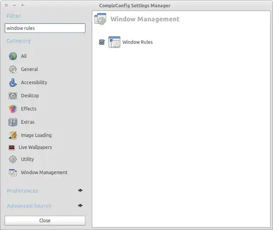

  2. Open CompizConfig Settings Manager and enable the Window Rules plugin:

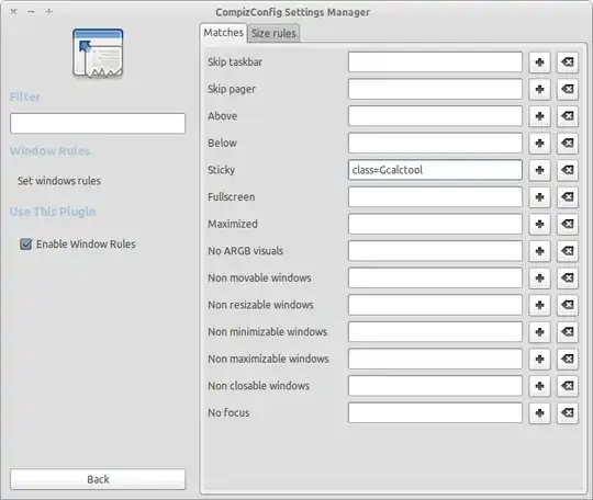

  3. In the Window Rules plugin, enter class=Gcalctool (If you are using a different calculator find out the class name by clicking the + button and then using the Grab feature).

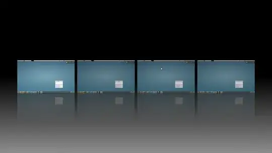

  4. Your calculator should now be visible on every workspace:
