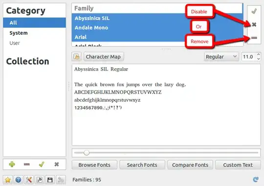

An easy way to do that is using font manager. Just press Ctrl+Alt+ T on your keyboard to open Terminal. When it opens, run the command(s) below:
sudo apt-get install font-manager
Once installed, run the program, highlight the fonts that you don't like, and either disable or remove them. See image below.
