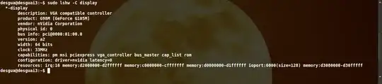

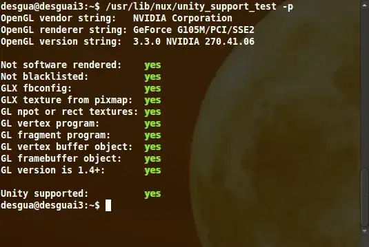

It appears to be a bug at the app that checks for drivers update - jockey see this.
You can test if it is in use at least in three ways. Check the commands and the outputs following:
/usr/lib/nux/unity_support_test -p
lspci | grep nVidia
sudo lshw -C display
Reference.

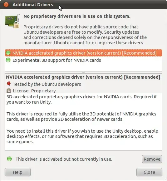

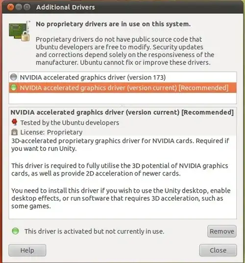

To quote your screenshot,
This driver is activated but not currently in use.
Have you restarted after you installed the Nvidia driver? You can't use it as long as the old driver is still loaded in the kernel.
Egil
  • 14,522

EDIT: As I see the screenshot, I can only recommend a single active driver rather than both. I think there are a lot of issues regarding newer Nvidia and Ubuntu
