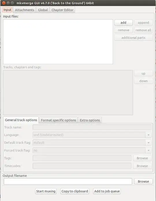

mkvmerge gui 1
The first thing that you'll need to do is to add the files containing all the needed streams. You do that (obviously) by pressing add button and selecting the file or by dragging your files into the "Input files" area. You should not use append button, unless your intention is to place the contents of one file after the contents of another (making the final file's duration the sum of all the appended ones).
Since you are saying you are planning to just convert .avi files, then you should simply add one file at the time. Note that the first file that you will add will automatically set the name of the output file, it will match the input name, but the extension will be changed to .mkv. You can of course change that if you wish.
After you add something you will be able to change the parameters of the streams (such as the assigned language, whether the track is "on" by default, and whether a user can chose to disable this stream all together if one wishes.
You can give the title for the stream. I suggest that if you have multi-audio video that you use that together with the language. For example you can have "original" or "single-voice dub" or "director's commentary" for the track names. Many players will show you these when you select the stream to play, and it is very useful. Try not to repeat the information there, however. There is no reason to write "English language" when you can just set the track's language code.

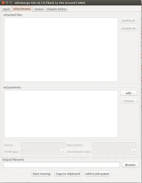

Sometimes you may wish to add some attachments to your file. If you add an image, many file managers will display this picture as the icon for the final video file. If you are muxing some sort of film, and you happen to have the cover for it, it may be a good choice to put it in as the attachment.

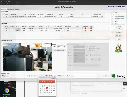

You could also use dmMediaConverter a free FFmpeg GUI. And you can do it without reencoding the video stream (depends on avi codec). Just grab the debs from here: http://dmsimpleapps.blogspot.ro/2014/04/dmmediaconverter.html
