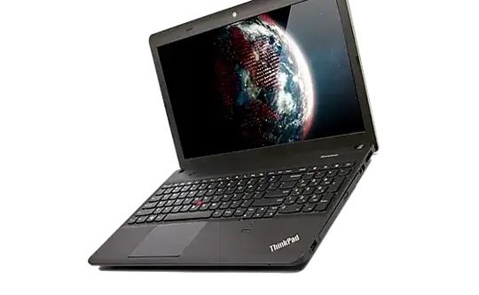

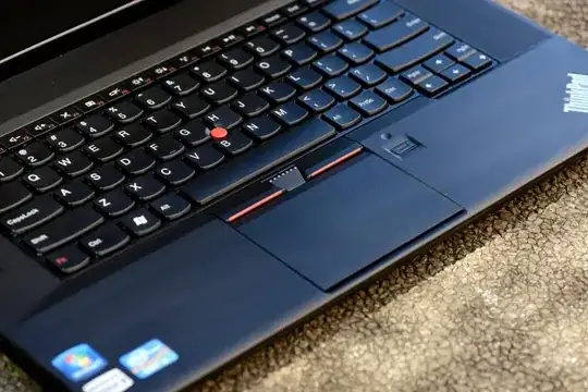

This is a picture of the e530 model:
e530
You can see it has a separate buttons above the touchpad which you can use when using the trackpoint.
This is a picture of my model (the e531):
e531
As you can see, there are no buttons. There is just the touchpad.
