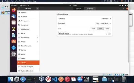

For Ubuntu 20.04 in a MacBookPro 13"
  1. In VirtualBox > Settings > Display Video Memory = 64MB VM Settings panel screenshot
  2. In Ubuntu20.04 [Virtual Machine]
    Settings > Displays > Resolution = 2560x1600
    Settings > Displays > Scale = 200%
    Ubuntu20.04 settings panel screenshot
Not FULL SCREEN, but it works for me
