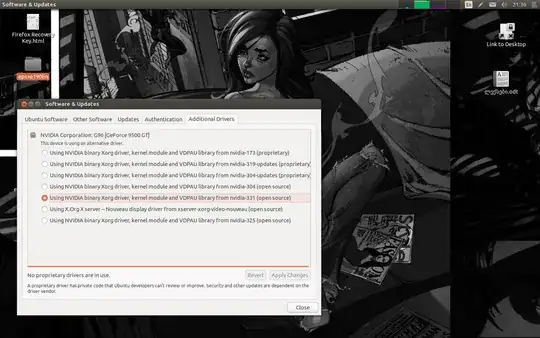

i'am a windows user. recently i now am switched in Ubuntu 13.10.. it's is every thing new for me... commanding and setting whatever it is every thing new for me.. and now my Pc monitor resolution is not set. i have a Nvidia Graphics card.. Soo it's is compalsary set that resolution setting how i don;t know how to set that settings.... i'am also updated Ubuntu 13.10 current graphic drive setting... but in Nvidia newly released Nvidia 331.45 version updated drive.. now in my pc Nvidia 319 Updated drive .. how to install that Nvidia 331.45 version

now open software & updates app select additional drivers and you will see new nvidia driver version enter image description here select it and press apply changes ignore that in the end it is written (open source) it is not open source drivers they are proprietary. after it will finish installing drivers reboot your pc and you will be using your new drivers. now you have your nvidia control panel in your dash and can change settings from it enter image description here
