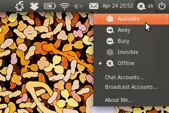

This is the first thing I do after logging in:
screenshot
How can I make it happen automatically?
