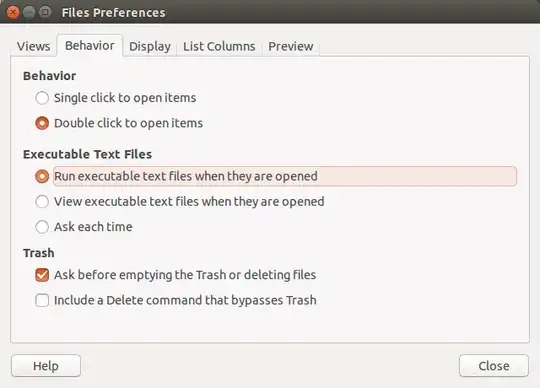

Before we even begin writing the script, open the file manager, go to Edit drop-down menu -> preferences -> Behavior, and check "Run executable text files when they are opened." That will actually let you run a script from the Desktop.

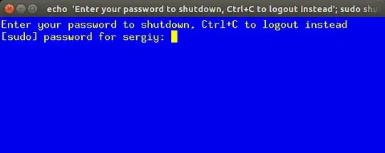

So here's the xterm window that pops-up when I hit enter on the script(excuse the bright colors):
Note, I mentioned that xterm -hold -e will hold xterm window until closed. That is, it will hold until you graphically close it, by pressing on the red x in the upper right corner, but if you plan to log out or shut down it won't be necessary, so we can ignore that. But what if you opened window, entered password, the system went for shutdown, and then half way you decided to cancel it? Then the window would hang around, and you would have to kill it graphically. Why? Because shutdown command exited sucessfully, so logical or would not execute gnome-session-quit part of the script. Also, in the script I wrote sudo shutdown -P +10, which will shutdown computer within 10 minutes, but if you want immediate shutdown, you may want to write now instead of +10 .
And one more thing: pay attention to the sequence of -hold and -e. If you place -e first, it will give you error, so to actually hold the window -hold has to be first.
