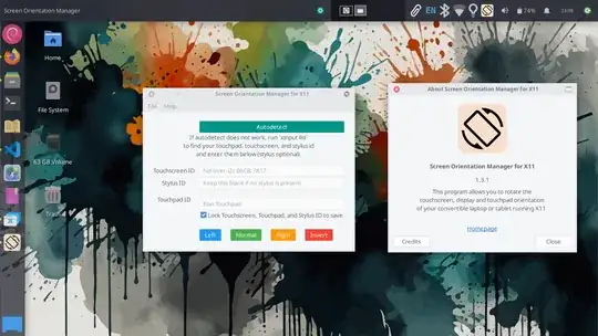

kael
  • 111
I've built a little GUI that can do that. Completely based on those open source scripts. Have a look at Screen Orientation Manager here.
This method works with X.Org with all DEs I have tested (GNOME/KDE/Cinnamon/XFCE/MATE/LXDE). It also works on ARM computers.
You'll have to install the Screen Orientation Manager app.
Download and install the .deb package from GitHub releases.
Alternatively, use the official PPA:
sudo add-apt-repository ppa:apandada1/screen-orientation-manager
sudo apt update
sudo apt install screen-orientation-manager
Run xinput list to get the ID for the touchscreen and touchpad, and enter them into the app (it will remember them).
Finally, add the Screen Orientation Manager app to the list of startup programs.
