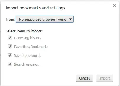

However, when I go to the Customize and Control button and then choose the option Import Bookmarks and Settings under the Bookmarks menu item, it gives me this:
No supported browser found
I have Firefox and Chromium as up to date as the official repositories (I believe), so I really have no clue what is going on.

EDIT: 10/31/2013 Turns out I mis-read the Ubuntu PPA. 13.04, Raring Ringtail, only has 28.0. Apparently I am to be forced to upgrade if I want software upgrades. Botheration.
I guess I will do so when I can, but does anyone know if I can force an upgrade of only certain software (Chromium for example.)
I just updated Ubuntu (not upgraded, I still have 13.04) and Chromium updated to 30.0.1599.114 (Developer Build 30.0.1599.114-0ubuntu0.13.04.2) Ubuntu 13.04 and I can now import from Firefox!
Thanks to @ChrisCarter for attempting to help me solve my issue, update did it!
