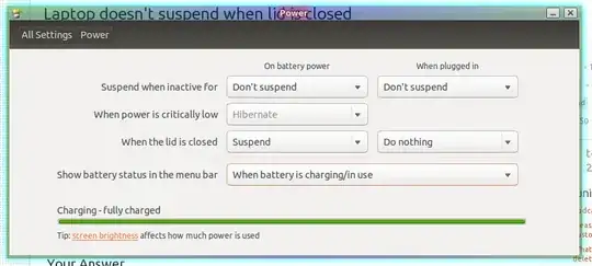

Go to System Settings > Power . From there you can change this. I'm attaching a photo about it. Power Settings
