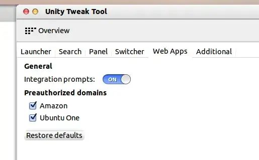

Install Unity tweak tool and then open it.. From there at Unity tab choose webapps . from there you can disable and enable it as you want.
hope that helps.

Or disable the "Unity Desktop Integration" Addon in the Addon-Manager at "extras" if you're using Firefox. Worked fine with me.
