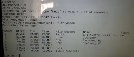

Here are results from Parted, and it is a bit confusing for me as the Mac partition is the one with boot:
Enter image description here
As you can see the entry 1 is an EFI system partition and is the boot partition, so I wonder if I should install GRUB there or in sda6, which is the Ubuntu filesystem.
