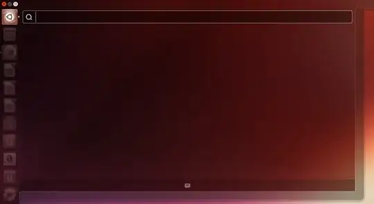

I upgraded from 13.04 to 13.10 and now all icons in the application lens are gone.
Screenshot of missing applications in Unity 13.10 application lens
This is what I tried so far:
  • apt-get install --reinstall unity-lens-applications
  • unity --replace and unity --reset-icons
  • moving ~/.config to ~/.config2
  • deleting ~/.cache/software-center and ~/.cache/unity
Most of these things have been suggested in this question: Unity Applications lens is empty - but all to no avail.

I think this is likely because the unity-scope-home package is not installed.
Try using Software Center to find and install that package, log out and back in to restart Unity, and see if that resolves the problem.

I think I may have had a similar problem, not sure it was due to upgrading to 13.10 or due to user error. I ended up fixing it as follows:
  1. Log out of unity and log in to tty1 (ctrl-alt-f1).
  2. "sudo apt-get purge unity" (gets rid of unity and it's settings).
  3. "sudo apt-get autoremove" (gets rid of any leftover packages that unity depended on, like the lenses and such.)
  4. "sudo reboot" and log into tty1 again afterwards.
  5. "sudo apt-get install unity"
Bit drastic, but it worked.
