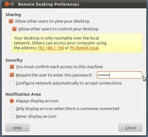

Can anyone say me how to set a VNC password in Ubuntu? Such that if anyone access my machine through VNC it should prompt for a password.

You can set a password when you open Remote Desktop.
Or withvncpasswd you can also set the password for the vnc-server.
So if someone want to connect to you, he has to enter the password.
