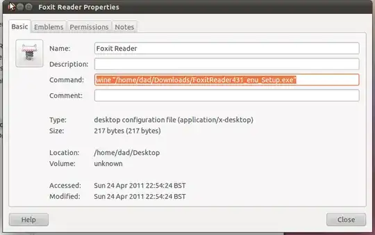

It appears that FoxIt have designed the windows version to act like its "portable" version if it detects the "setup.exe" running under Wine.
This means that it doesnt need to be 'installed'. You can create a Launcher if you
  • Right-click on your desktop.
  • In the Command Line entry Browse to where the setup.exe was downloaded.
  • Then amend the entry to look like the following: enter image description here
Similarly (if using Lucid or Maverick),
  • right-click the menu in the top panel and choose the option "edit menu".
  • Locate where you want to locate the new menu option and create the new menu option using the same Command Line entry as in the screen-shot.

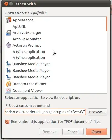

If you want to use the Windows Foxit Reader automatically when you double click a .pdf file then the instructions are very similar:
  • Right click the PDF and choose the option "Open with other application"
  • Use the Command Line syntax as above but append \"z:%f\" i.e. it should look like: enter image description here
Remember to leave the check box "Remember this application.." ticked
