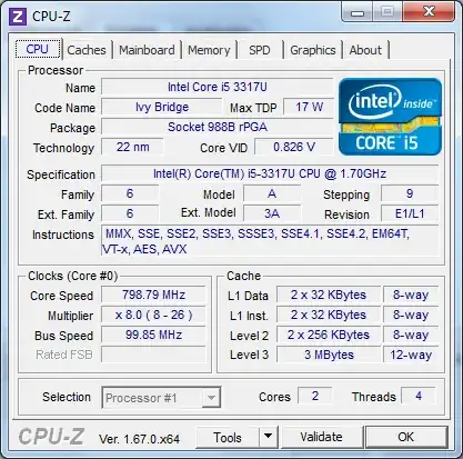

However I'd like to enable multiple cores - as seen in the image below my Windows machine has 2 cores:

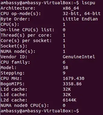

Now when I run the lscpu in Ubuntu I get the following info revealing that only 1 core is being utilized:

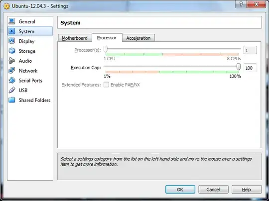

I've tried changing the settings of the virtual box to enable multiple processors but it won't allow me to do so as shown in the image below:

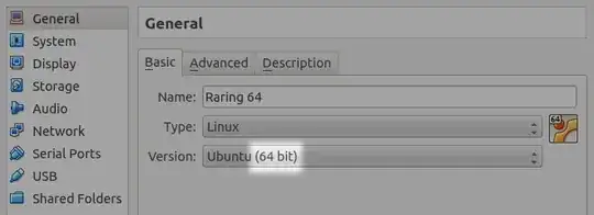

  • 64-bit virtual guest hardware in General settings tab (for 64-bit guests)

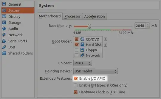

  • enable I/O APIC in the Motherboard settings tab

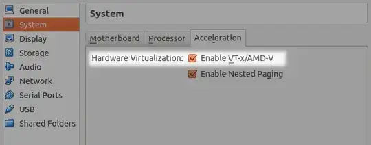

  • enable hardware virtualization (VT-x/AMD-V) in the Acceleration tab
