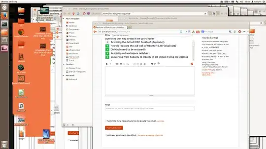

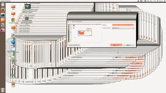

My Ubuntu Desktop display system has been crashed after automated updates via update manager. How can restore my old version of Ubuntu Desktop? Selecting any part and moving mouse anywhere cause this effect
A crash print screen
