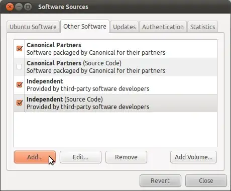

You can easily add them in the Software Center->Edit->Software Sources->Other Sources->Add"
  1. Start the Software Center.
  2. In the panel go to Edit and select Software Sources.
    edit-software-sources
  3. In the tab Other Sources click on the Add button at the bottom.
    other-sources

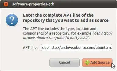

  4. Add the deb URL in the APT Line input field and hit Add Source.
    software-properties-gtk
Once you close the Software Sources window your cache is going to be updated automatically.
