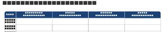

We're using wkhtmltopdf in a web project (nodejs/compoundjs). We've gotten it working how we wanted on our machines (using the --use-xserver switch). However, when I try to run this on our Ubuntu server 12.04 (without the ubuntu-desktop package), the PDF cannot use the switch. When we disable the switch, the PDF displays any characters as blocks (image below).
How do I resolve this without installing ubuntu-desktop and running x server?
I've found liberation fonts, which installing ttf-liberation and fonts-liberation did not help. And urw-fonts, but I have yet to find an Ubuntu equivalent.
PDF Output

In fact wkhtmltopdf on linux requires quite a lot of Xorg as mentioned on the project page:
(Linux) No longer requires an XServer to be running (however the X11 client libs must be installed)
You should install the client libs as well.

This bug report suggests that wkhtmltopdf just needs whatever xorg-x11-fonts provides:
$ wajig list-installed xfonts
xfonts-base
xfonts-encodings
xfonts-mathml
xfonts-scalable
xfonts-utils
So try installing those. Note that you'll pull in several X dependencies, but not the server itself.
