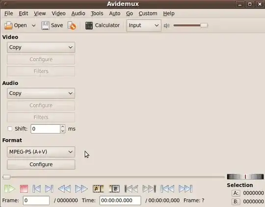

I tend to recommend leaving files in their original state, as any conversion has a chance to introduce loss. The .ts video format is a container format for MPEG, known as "Transport Stream", which is used most frequently by digital broadcasting systems (digital cable, satellite, etc). Many applications are unfamiliar with how to decode it, since it has a very different multiplexing format than the more conventional MPEG container known as "Program Stream", which is what is used on DVDs, and what is produced by many encoder cards. The difference between TS and PS is only how the packet structure is built; the A/V data inside it is the same.
To get better interoperability, I recommend converting the container from TS to PS. Virtually every piece of software that can decode TS can decode PS, so it's almost always better to have PS file. One of the simplest remuxing tools I've found to use is avidemux. Just choose "copy" for the video and audio streams, and choose the "PS" container format for MPEG:
avidemux
Then just save out the result. This can also be done using ffmpeg. You just need to select the copy codec for each stream type:
ffmpeg -i input.ts -vcodec copy -acodec copy output.mpg
