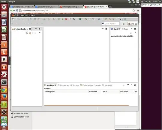

I just downloaded and try to run Eclipse Kepler on Ubuntu 13.10. If I run Eclipse with command
./eclipse
Eclipse runs, but very weird :(
Nut if I run with the command
sudo ./eclipse
everything runs fine. But I don't want to sudo. Please help me.
