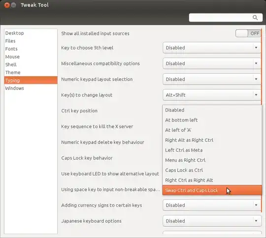

It doesn't look like the Keyboard Layout Options dialog is going to come back. You can swap the caps-lock and control keys in gnome-tweak-tool, under "Typing."
Screenshot:
gnome-tweak-tool

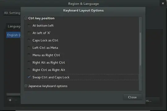

I don't know how you did, but here is the reason:
In the Layout Preferences, there is an Option button, it should open a window like this:
As you can see, the subtree under "Ctrl key position" has an option to swap Ctrl and Caps Lock. When I activate it this is how looks my preview:
Desactivating the option brings everything to normal.
