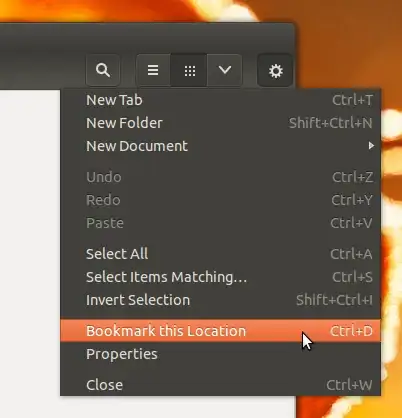

Add a bookmark:
  1. Open the folder (or location) that you want to bookmark.
  2. Click the gear button in the toolbar and pick Bookmark this Location.

The "gear button" is on the right side of Nautilus:
Bookmark this location - Nautilus - Ubuntu 13.10
It will be grayed out if the location you've opened is already bookmarked.

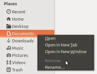

The bookmarks seen under the "Places" heading are an exception:
Remove grayed out - Places - Nautilus - Ubuntu 13.10
They're not just bookmarks, but XDG user directories with a separate configuration backend, so the Nautilus developers deliberately chose to disable removing them.
The issue of working around this limitation is being discussed in this question.
