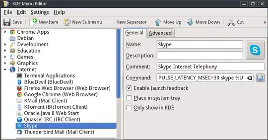

Another non-terminal way is to to right-click on start button and select "Edit applications...":
NOTE: If you are using KDE session restoring (System Settings -> Startup and Shutdown -> Session Management -> On login: Restore previous session) then after system restart (or login) Skype will not catch PULSE_LATENCY_MSEC environment variable until you restart it via its .desktop file.
