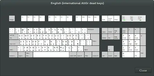

The layout you need is the "English (International with AltGr dead keys)"
pressing AltGr + , brings the ç. AltGr + Shift + , brings Ç

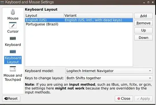

I use a Logitech K480 and my layout in NixOS + LXQt is English International + dead keys.
And I didn't found a good solution. But I found out that if I press:
Solution for Logitech + NixOS + LXQt:
AltGr (Alt Right) + , (comma) it shows a ç.
And SHIFT + AltGr + , = Ç

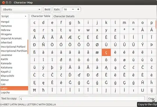

Another way is to use Character Map:
Open Character Map
Character Map

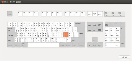

And another way and probably the best is to use a keyboard layout like Portuguese:
Portuguese keyboard layout
