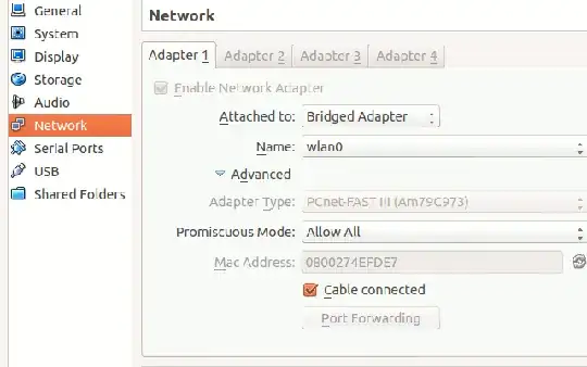

This is an image showing an example of the settings you need (taken from this answer).
Virtualbox Network Settings

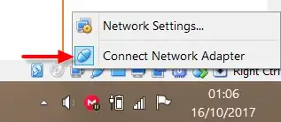

If it was working fine until recently, but suddenly your VM seems to have lost network connectivity while the host seems to have normal internet connection, then maybe just try the following steps.
Step 1: Right click on the network icon for the VM, Which most of the time will be on the bottom right corner in windowed mode.
VirtualBox Networking stopped working
Step 2: Toggle off the button named "Connect Network Adapter" and after waiting for like 10 seconds toggle it back on.
Another solution: If you are on windows Host, Go to Control Panel\Network and Internet\Network Connections right click any of the Virtualbox adapter and select Diagnose, let it do its thing and if it finds some anomaly with the adapter it will give you a prompt to reset the adapter by Apply the recommended solution/changes , you opt in for that, after its done, you most probably should have the network back to normal in your virtual machine.
I have to do this step almost regularly since I rarely shutdown my PC and always put it to sleep so after waking up I frequently encounter this issue.
VirtualBox Networking stopped working suddenly
For wireless to work, in my machines anyway, the WiFi MAC address in Settings must match the hardware, and wlan0 must be selected (when host Internet comes through wireless).
EDIT:
After gaining much more experience with this, I find:
  1. The initial network connection is very finicky and inconsistent.
  2. Once made, it reconnects every time with no problem.
  3. The MAC address does not need to match the hardware (as initially stated).
  4. Because of 1., trouble with the VM Internet connection is best remedied by unbridging and/or changing the MAC, starting the VM, stopping, re-bridging, etc. Sooner or later, it will connect.
[/EDIT]
Here's a quick HowTo:
First click your network icon and select Connection Information.
On the Hardware Address line, copy the MAC address (the six digit-pairs separated by colons).
Paste in a neutral location such as a text editor, where the colons can be edited out (remove them). Copy the rendered 12 characters remaining.
Note: Attempts to paste the MAC with the colons still present will fail.
With the latest VirtualBox (VBox) available from *buntu repos, v4.1.12 at this writing:
In VBox, with the VM selected, click Settings. Click Network and on that page, typically under the Adapter 1 tab, click Advanced.
Click the dropdown at Attached to: and select Bridged Adapter. Highlight the 'Mac Address' data and delete it. Paste the true MAC address copied above.
Check parameters are set as follows, in order from top-to-bottom:
  • Enable Network Adapter: checked
  • Attached to: Bridged Adapter
  • Name: wlan0
Under 'Advanced'
  • Adapter Type: the one with "Desktop" in the name
  • Promiscuous Mode: Allow All
  • Mac Address: as copied and pasted above
  • Cable Connected: checked
Note that in the VM window, for Win7 at least, the WiFi symbol appears different from what it is in native mode. But WiFi is running nonetheless.
